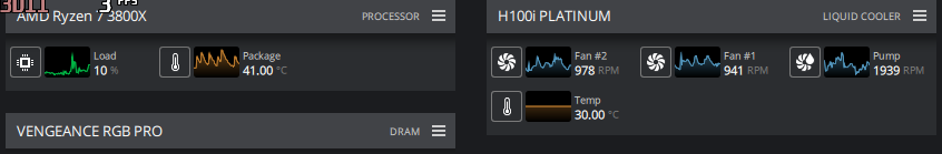

Pósturaf osek27 » Þri 29. Des 2020 19:55
Kælirinn sjálfur er í 30 gráðum meðan ryzen er að hoppa upp og niður.

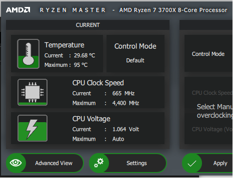

Pósturaf Xmatic » Mið 30. Des 2020 13:49
Always use Ryzen Master to see your actual temps. An AMD employee explained why other programs read the temp and the state of the processor wrong. Here is my idle temp,around 30c, ARCTIC Freezer 34 eSports DUO.
EDIT. Added temps using the stress test provided by the Ryzen program.

Pósturaf Dropi » Mið 30. Des 2020 14:48
Xmatic skrifaði:Always use Ryzen Master to see your actual temps. An AMD employee explained why other programs read the temp and the state of the processor wrong. Here is my idle temp,around 30c, ARCTIC Freezer 34 eSports DUO.
Datt það ekki í hug, prófaði og sé 5-10°C lægri hita á RyzenMaster miðað við HWInfo. Ekki jafn mikið flökt á hitanum heldur.

Pósturaf Xmatic » Mið 30. Des 2020 14:51
Dropi skrifaði:
Apprently other programs constantly "ask" and wake up the processor, thats why you see the sudden spikes, it is waking up the cores that are in C6 sleep.
